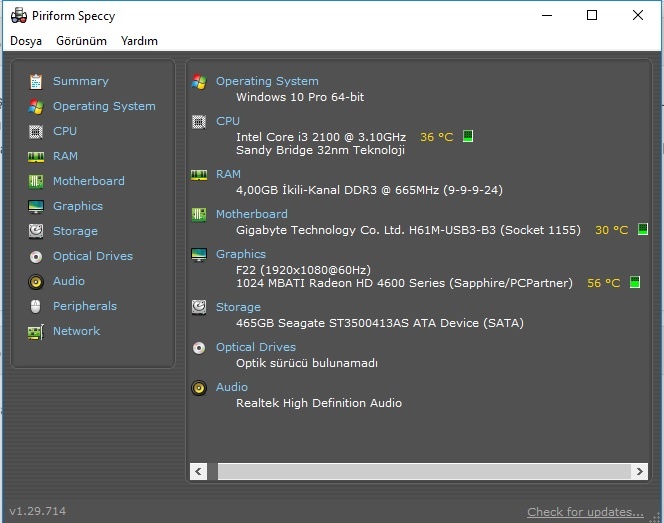

  12. kadir says:
    9 yıl önce
    https://uploads.disquscdn.com/images/60c5204ac25f8ea1562946db86e43d093d132e3c396511ede7a688638737c46d.jpg uyumlumu ???
    Yanıtla
