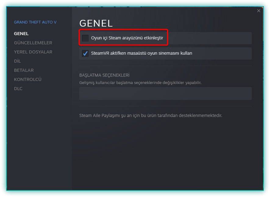

Hocam steam de olsa satın alıcağım fakat mecbur yok, bu arada gta san andreas'den kastığım MTA'idi, hocam başka ne yapabilirim, hocam bu arada üstteki SYSTEM adlı minidump steamden portal 2 oyunundan, dediklerinizi portal 2'ye yapsam olur mu?Steam'den oynuyorsunuz değil mi?
Kütüphaneden GTA San Andreas'a sağ tıklayıp özellikler dedikten sonra "Oyun içi Steam arayüzünü etkinleştir" kısmının tikini kaldırıp dener misiniz?
Eki Görüntüle 1521725
Dökümler:
Kod:******************************************************************************* * * * Bugcheck Analysis * * * ******************************************************************************* KERNEL_SECURITY_CHECK_FAILURE (139) A kernel component has corrupted a critical data structure. The corruption could potentially allow a malicious user to gain control of this machine. Arguments: Arg1: 0000000000000003, A LIST_ENTRY has been corrupted (i.e. double remove). Arg2: ffffec0552b10990, Address of the trap frame for the exception that caused the BugCheck Arg3: ffffec0552b108e8, Address of the exception record for the exception that caused the BugCheck Arg4: 0000000000000000, Reserved Debugging Details: ------------------ KEY_VALUES_STRING: 1 Key : Analysis.CPU.mSec Value: 1687 Key : Analysis.DebugAnalysisManager Value: Create Key : Analysis.Elapsed.mSec Value: 6244 Key : Analysis.Init.CPU.mSec Value: 328 Key : Analysis.Init.Elapsed.mSec Value: 12174 Key : Analysis.Memory.CommitPeak.Mb Value: 138 Key : Bugcheck.Code.DumpHeader Value: 0x139 Key : Bugcheck.Code.Register Value: 0x139 Key : FailFast.Name Value: CORRUPT_LIST_ENTRY Key : FailFast.Type Value: 3 Key : WER.OS.Branch Value: vb_release Key : WER.OS.Timestamp Value: 2019-12-06T14:06:00Z Key : WER.OS.Version Value: 10.0.19041.1 FILE_IN_CAB: 091822-125640-01.dmp BUGCHECK_CODE: 139 BUGCHECK_P1: 3 BUGCHECK_P2: ffffec0552b10990 BUGCHECK_P3: ffffec0552b108e8 BUGCHECK_P4: 0 TRAP_FRAME: ffffec0552b10990 -- (.trap 0xffffec0552b10990) NOTE: The trap frame does not contain all registers. Some register values may be zeroed or incorrect. rax=ffff9608363f2158 rbx=0000000000000000 rcx=0000000000000003 rdx=ffff96083596c158 rsi=0000000000000000 rdi=0000000000000000 rip=fffff80216816277 rsp=ffffec0552b10b20 rbp=fffff80214ee2180 r8=ffff96083d848280 r9=ffff9608363f21c0 r10=0000000000000000 r11=ffffd5037f5d2940 r12=0000000000000000 r13=0000000000000000 r14=0000000000000000 r15=0000000000000000 iopl=0 nv up ei pl nz na po nc nt!KiSignalThread+0x1f8217: fffff802`16816277 cd29 int 29h Resetting default scope EXCEPTION_RECORD: ffffec0552b108e8 -- (.exr 0xffffec0552b108e8) ExceptionAddress: fffff80216816277 (nt!KiSignalThread+0x00000000001f8217) ExceptionCode: c0000409 (Security check failure or stack buffer overrun) ExceptionFlags: 00000001 NumberParameters: 1 Parameter[0]: 0000000000000003 Subcode: 0x3 FAST_FAIL_CORRUPT_LIST_ENTRY BLACKBOXBSD: 1 (!blackboxbsd) BLACKBOXNTFS: 1 (!blackboxntfs) BLACKBOXPNP: 1 (!blackboxpnp) BLACKBOXWINLOGON: 1 CUSTOMER_CRASH_COUNT: 1 PROCESS_NAME: svchost.exe ERROR_CODE: (NTSTATUS) 0xc0000409 - Sistem, bu uygulamada y n tabanl bir arabelle in ta t n alg lad . Bu ta ma, k t niyetli bir kullan c n n bu uygulaman n denetimini ele ge irmesine olanak verebilir. EXCEPTION_CODE_STR: c0000409 EXCEPTION_PARAMETER1: 0000000000000003 EXCEPTION_STR: 0xc0000409 STACK_TEXT: ffffec05`52b10668 fffff802`1680af69 : 00000000`00000139 00000000`00000003 ffffec05`52b10990 ffffec05`52b108e8 : nt!KeBugCheckEx ffffec05`52b10670 fffff802`1680b390 : 00000000`00000000 00000000`00000000 00000000`00000000 00000000`00000000 : nt!KiBugCheckDispatch+0x69 ffffec05`52b107b0 fffff802`16809723 : ffffd503`6f99a1a0 00000000`00000000 ffff9608`2f0cca60 00000000`00000001 : nt!KiFastFailDispatch+0xd0 ffffec05`52b10990 fffff802`16816277 : ffffec05`52b10c28 00000000`00000000 000001be`9ea29c00 000001be`9ea2e070 : nt!KiRaiseSecurityCheckFailure+0x323 ffffec05`52b10b20 fffff802`1661b4bf : fffff802`14ee2180 000001be`00000000 ffff9608`373321c0 ffff9608`363f2080 : nt!KiSignalThread+0x1f8217 ffffec05`52b10b60 fffff802`1661d705 : 00000000`00000000 00000000`00000000 ffff9608`3d286f00 ffffec05`52b10c28 : nt!KiWakeQueueWaiter+0xbf ffffec05`52b10bb0 fffff802`1680a9b5 : ffff9608`352b4080 00000000`00000000 ffff9608`2fe45d70 00000000`c0000034 : nt!NtReleaseWorkerFactoryWorker+0x235 ffffec05`52b10c40 00007fff`d5defdd4 : 00000000`00000000 00000000`00000000 00000000`00000000 00000000`00000000 : nt!KiSystemServiceCopyEnd+0x25 0000004d`bb9fe208 00000000`00000000 : 00000000`00000000 00000000`00000000 00000000`00000000 00000000`00000000 : 0x00007fff`d5defdd4 SYMBOL_NAME: nt!KiFastFailDispatch+d0 MODULE_NAME: nt IMAGE_NAME: ntkrnlmp.exe IMAGE_VERSION: 10.0.19041.2006 STACK_COMMAND: .cxr; .ecxr ; kb BUCKET_ID_FUNC_OFFSET: d0 FAILURE_BUCKET_ID: 0x139_3_CORRUPT_LIST_ENTRY_nt!KiFastFailDispatch OS_VERSION: 10.0.19041.1 BUILDLAB_STR: vb_release OSPLATFORM_TYPE: x64 OSNAME: Windows 10 FAILURE_ID_HASH: {3aede96a-54dd-40d6-d4cb-2a161a843851} Followup: MachineOwner ---------
Kod:******************************************************************************* * * * Bugcheck Analysis * * * ******************************************************************************* SYSTEM_SERVICE_EXCEPTION (3b) An exception happened while executing a system service routine. Arguments: Arg1: 00000000c0000005, Exception code that caused the BugCheck Arg2: fffff8051a1fdfc9, Address of the instruction which caused the BugCheck Arg3: ffff89814ae206f0, Address of the context record for the exception that caused the BugCheck Arg4: 0000000000000000, zero. Debugging Details: ------------------ KEY_VALUES_STRING: 1 Key : Analysis.CPU.mSec Value: 2217 Key : Analysis.DebugAnalysisManager Value: Create Key : Analysis.Elapsed.mSec Value: 7426 Key : Analysis.Init.CPU.mSec Value: 311 Key : Analysis.Init.Elapsed.mSec Value: 40620 Key : Analysis.Memory.CommitPeak.Mb Value: 128 Key : Bugcheck.Code.DumpHeader Value: 0x3b Key : Bugcheck.Code.Register Value: 0x3b Key : WER.OS.Branch Value: vb_release Key : WER.OS.Timestamp Value: 2019-12-06T14:06:00Z Key : WER.OS.Version Value: 10.0.19041.1 FILE_IN_CAB: 091822-119687-01.dmp BUGCHECK_CODE: 3b BUGCHECK_P1: c0000005 BUGCHECK_P2: fffff8051a1fdfc9 BUGCHECK_P3: ffff89814ae206f0 BUGCHECK_P4: 0 CONTEXT: ffff89814ae206f0 -- (.cxr 0xffff89814ae206f0) rax=ffffa68f6aef8000 rbx=00000000edaa57d7 rcx=00000000000005c1 rdx=ffffa68f6aefae08 rsi=ffffa68f6af28a90 rdi=00000000d49541eb rip=fffff8051a1fdfc9 rsp=ffff89814ae210f0 rbp=ff000000ff000000 r8=ffff89814ae21100 r9=0000000000000002 r10=7ffffffffffffffc r11=000000000000004c r12=ffffa68f6ae71000 r13=0000000000000001 r14=ffffa68f6af28a90 r15=ffff89814ae213e0 iopl=0 nv up ei ng nz na po nc cs=0010 ss=0018 ds=002b es=002b fs=0053 gs=002b efl=00010286 nt!CmpPerformSingleKcbCacheLookup+0x139: fffff805`1a1fdfc9 395d00 cmp dword ptr [rbp],ebx ss:0018:ff000000`ff000000=???????? Resetting default scope BLACKBOXBSD: 1 (!blackboxbsd) BLACKBOXNTFS: 1 (!blackboxntfs) BLACKBOXPNP: 1 (!blackboxpnp) BLACKBOXWINLOGON: 1 CUSTOMER_CRASH_COUNT: 1 PROCESS_NAME: GameOverlayUI.exe STACK_TEXT: ffff8981`4ae210f0 fffff805`1a1fbf97 : ffffa68f`6af28a90 ffffa68f`6af27050 ffffba86`46b5d080 ffffa68f`00000002 : nt!CmpPerformSingleKcbCacheLookup+0x139 ffff8981`4ae21180 fffff805`1a1fc3da : 00000000`00000000 ffff8981`4ae21200 ffff8981`00000002 00000000`00000000 : nt!CmpPerformCompleteKcbCacheLookup+0x77 ffff8981`4ae21210 fffff805`1a1fb233 : ffffa68f`0000001c ffff8981`4ae21560 ffff8981`4ae21518 ffffba86`472d0a20 : nt!CmpDoParseKey+0x2da ffff8981`4ae214b0 fffff805`1a1ff2fe : fffff805`1a1faf01 00000000`00000000 ffffba86`472d0a20 00000001`1d13f001 : nt!CmpParseKey+0x2c3 ffff8981`4ae21650 fffff805`1a228b2a : ffffba86`472d0a00 ffff8981`4ae218b8 00000000`00000040 ffffba86`400dd560 : nt!ObpLookupObjectName+0x3fe ffff8981`4ae21820 fffff805`1a22890c : 00000000`00000000 00000000`00000000 00000000`00000000 ffffba86`400dd560 : nt!ObOpenObjectByNameEx+0x1fa ffff8981`4ae21950 fffff805`1a228431 : 00000000`002ce008 ffff8981`4ae21cc0 00000000`00000001 00000000`00000000 : nt!ObOpenObjectByName+0x5c ffff8981`4ae219a0 fffff805`1a22815f : 00000000`77394660 00000000`002cfda0 00000000`002ce970 00000000`004dd000 : nt!CmOpenKey+0x2c1 ffff8981`4ae21c00 fffff805`1a00a9b5 : ffffba86`46b50000 00000000`00000006 00000000`00000000 00000000`00000000 : nt!NtOpenKeyEx+0xf ffff8981`4ae21c40 00007ffa`0602f3f4 : 00000000`00000000 00000000`00000000 00000000`00000000 00000000`00000000 : nt!KiSystemServiceCopyEnd+0x25 00000000`002cdfa8 00000000`00000000 : 00000000`00000000 00000000`00000000 00000000`00000000 00000000`00000000 : 0x00007ffa`0602f3f4 SYMBOL_NAME: nt!CmpPerformSingleKcbCacheLookup+139 MODULE_NAME: nt IMAGE_NAME: ntkrnlmp.exe IMAGE_VERSION: 10.0.19041.2006 STACK_COMMAND: .cxr 0xffff89814ae206f0 ; kb BUCKET_ID_FUNC_OFFSET: 139 FAILURE_BUCKET_ID: AV_nt!CmpPerformSingleKcbCacheLookup OS_VERSION: 10.0.19041.1 BUILDLAB_STR: vb_release OSPLATFORM_TYPE: x64 OSNAME: Windows 10 FAILURE_ID_HASH: {512f7225-a3af-99ba-ceb2-61cb1878b377} Followup: MachineOwner ---------
Dökümlerden birinde "GameOverlayUI.exe" görünce Steam arayüzü ile alakalı olabileceğini düşündüm, o yüzden kapatıp deneyebilirsiniz demiştim aslında. Portal 2'de belki işe yarayabilir ancak yaramazsa biraz daha detaylı incelemek lazım.
Yok estağfurullah, o önemli değil. Sorun çözülsün yeter. Yine de teşekkür ederim.Hocam konu sonunda çözüldü olarak işaretlemeyi ihlal etmeyeceğim.

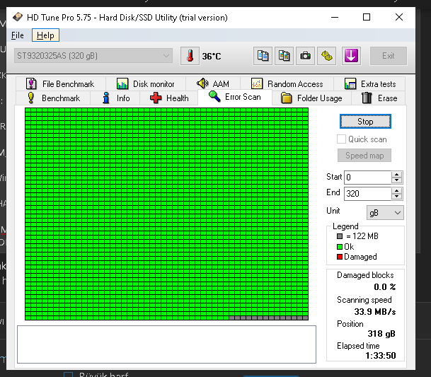

Hocam şuanlık 1 tane turuncu çıktı, dahasını kontrol edip yazıcağım, çok teşekkürler.Bu sefer direk disk ile alakalı problem var.
HD Tune indirip "Quick scan" kapalı olacak şekilde yani uzun olan testi yapar mısınız? Bad sector olabilir, HDD miadını dolduruyor belki de.

Hocam sanırım galiba harddisk arızalı daha da çıkıyor, eskiden yaptığım da sorun yoktu.Bu sefer direk disk ile alakalı problem var.

Hocam dün akşam yarısına kadar yaptım, 1 tane kırmızı, 3-4 tane sarı çıktı, yarıya kadar yapabildim, şimdi yaptım hepsi yeşil çıktı? dün gece böyle değidi, şimdi niye değişti anlamadım.Bu sefer direk disk ile alakalı problem var.

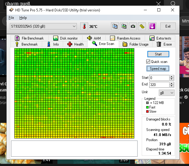

Hocam HD TUNE'de Speed map'e alınca işler değişiyor, aşşağı da bırakıyorum ben de dün gece speed map'e tıklamıştım.Bu sefer direk disk ile alakalı problem var.
