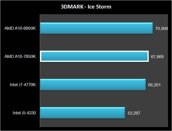

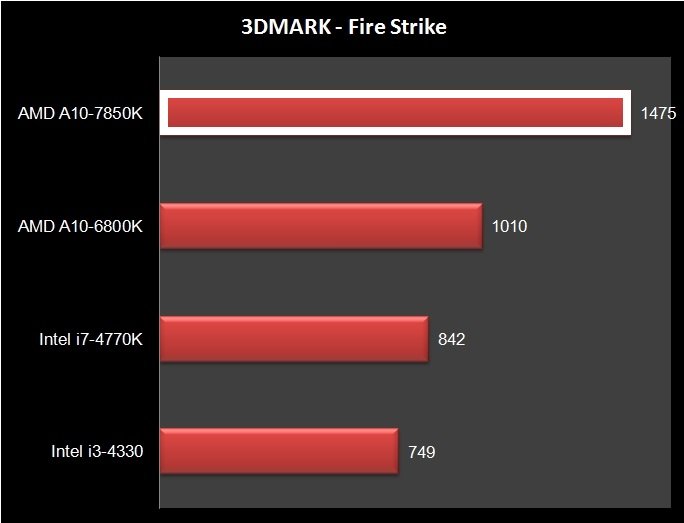

3DMARK 11
Test (1)
AMD A10-7850K (6)
AMD A10-7850K (10)
AMD A10-7850K (11) AMD A10-7850K (12)

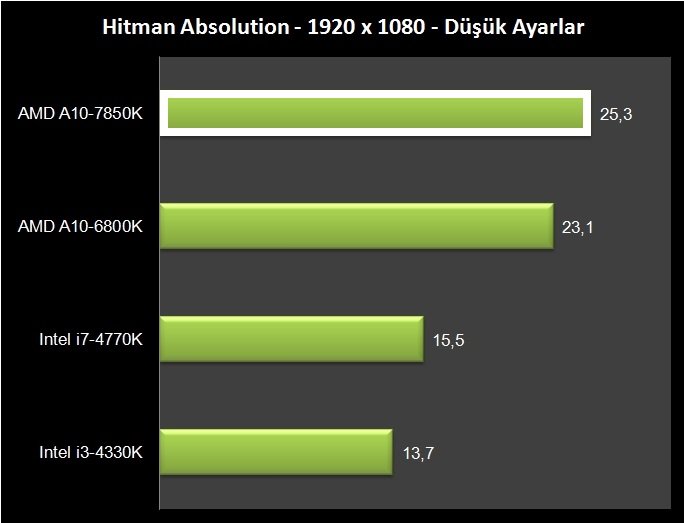

Hitman Absolution
AMD A10-7850K (7)

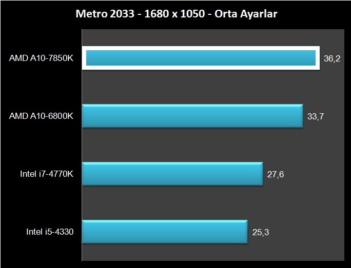

Metro 2033
AMD A10-7850K (8)

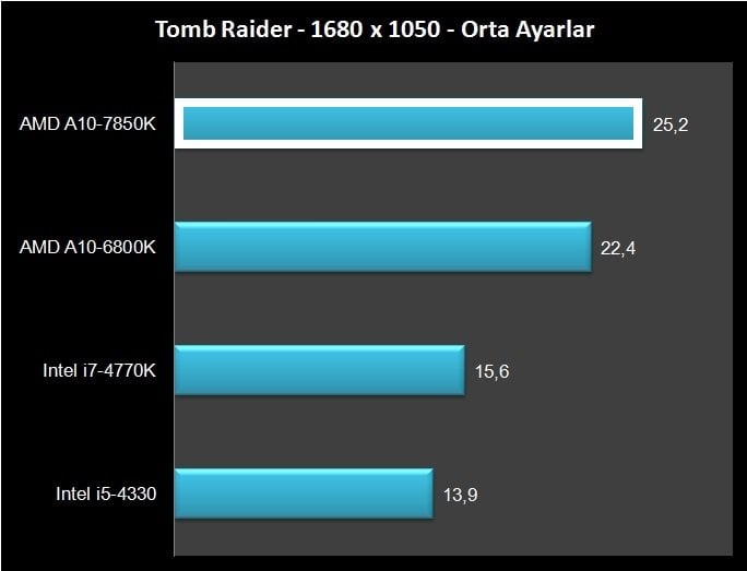

Tomb Raider
AMD A10-7850K (9)
