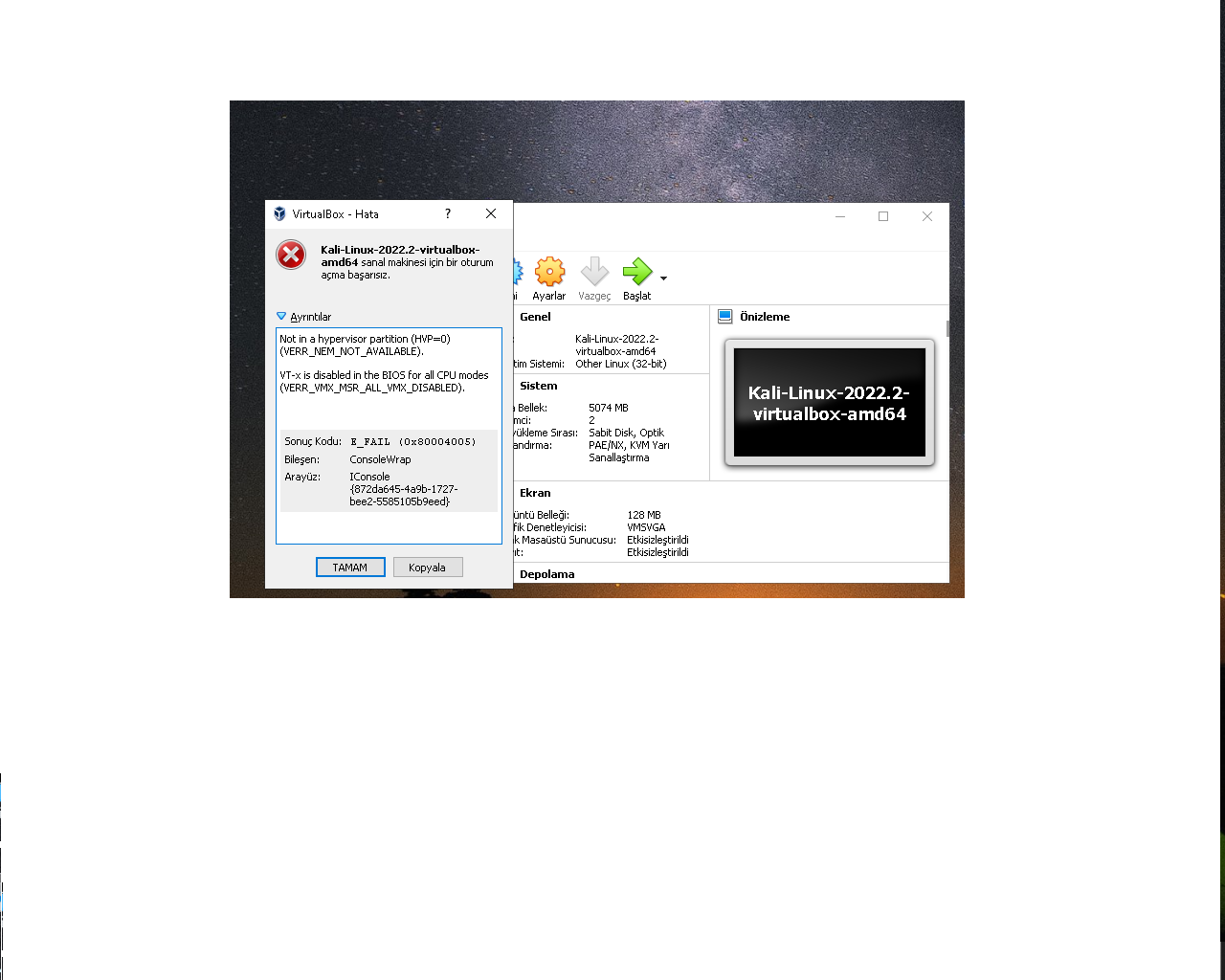

Merhaba arkadaşlar sormak istediğim i 3770 işlemcili sistemim var Kali Linux hata veriyor işlemci için.
  • i7 3770.
  • 8 GB(4+4) 1600 MHz.
  • 120 GB.
  • 500GB.
  • Foxconn 2abf.
  • 300W HP.
  • HP 3500 Pro.
Verdiği hata: Not in a hypervisor Partition (hvp = 0) (verr_nem_not_avaılable).
Vt-X is disabled in the BIOS for all CPU modes (verr_vmx_msr_all_vmx_dısabled).)
Sonuç kodu: E_faıl (0x80004005)
Bileşen: Consolewrap.
Arayüz: Iconsole {872DA645-4A9b-1727-BEE2-5585105B9eed}
Merhaba arkadaşlar, sormak istediğim i 3770 işlemcili sistemim var Kali Linux hata veriyor işlemci için.
  • i7 3770.
  • 120 GB.
  • 500GB.
  • Foxconn 2abf.
  • 300W HP.
  • HP 3500 Pro.
Eki Görüntüle 1430937

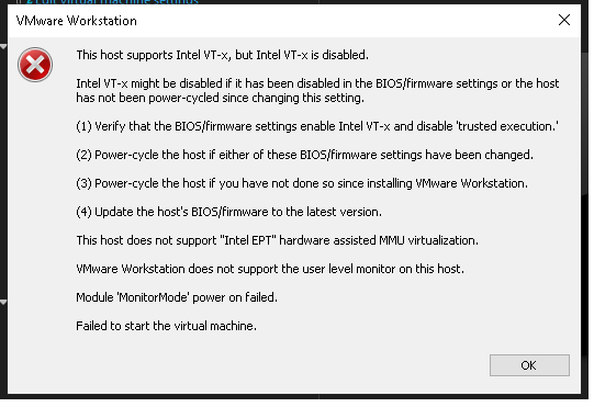

VMware e kurdum düzgün şekilde açarken yine hata verdi
This host supports Intel VT-x, but Intel VT-x is disabled.
Intel VT-x might be disabled if it has been disabled in the BIOS/firmware settings or the host has not been power-cycled since changing this setting.
(1) Verify that the BIOS/firmware settings enable Intel VT-x and disable 'trusted execution.'
(2) Power-cycle the host if either of these BIOS/firmware settings have been changed.
(3) Power-cycle the host if you have not done so since installing VMware Workstation.
(4) Update the host's BIOS/firmware to the latest version.
This host does not support "Intel EPT" hardware assisted MMU virtualization.
VMware Workstation does not support the user level monitor on this host.
Module 'MonitorMode' power on failed.
Failed to start the virtual machine.
VMware'e kurdum düzgün şekilde açarken yine hata verdi.
This host supports Intel vt-X, but Intel vt-X is disabled.
Intel vt-X might be disabled if it has been disabled in the BIOS/firmware settings or the host has not been Power-cycled since changing this setting.
(1) verify that the BIOS/firmware settings enable Intel vt-X and disable 'trusted execution.'
(3) Power-cycle the host if you have not done so since installing VMware workstation.
This host does not Support "Intel ept" hardware assisted mmu virtualization.
VMware workstation does not Support the user level monitor on this host.
Module 'monitormode' Power on failed.
Failed to start the Virtual machine.Eki Görüntüle 1431881
