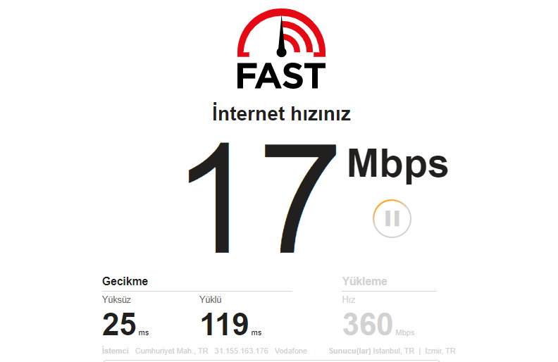

Arkadaşlar 2 yıl önce 80 Mbps alırken şimdi 55 zor görüyor ve akşam hız düşmeleri yaşıyorum CAT 5 kablo kullanıyorum CAT 6 geçmeli miyim hat değerlerim nasıl?
============================================================================= xDSLFwVersion: FwVer:5.12.23.0_B_A60901 HwVer:T14.F7_0.0 Line State: Up Modulation: ITU G.993.2(VDSL2) Annex Mode: ANNEX_B ============================================================================= INP downstream: 57817 INP upstream: 14869 shineGINPdownstream: 0 shineGINPupstream: 0 reinGINPdownstream: 0 reinGINPupstream: 0 TPSTC type: 64/65B PTM TC near-end interleaved channel bit rate: 0 kbps near-end fast channel bit rate: 55258 kbps far-end interleaved channel bit rate: 0 kbps far-end fast channel bit rate: 8191 kbps near-end FEC error fast: 1696032 near-end FEC error interleaved: 0 near-end CRC error fast: 42964 near-end CRC error interleaved: 0 near-end HEC error fast: 0 near-end HEC error interleaved: 0 far-end FEC error fast: 26 far-end FEC error interleaved: 0 far-end CRC error fast: 7 far-end CRC error interleaved: 0 far-end HEC error fast: 0 far-end HEC error interleaved: 0 DSL uptime : 8:36, 7 secs DSL activetime :0 min, 16 secs Downstream: relative capacity occupation: 100% noise margin downstream: 9.0 dB output power upstream: 8.7 dbm attenuation downstream: 16.4 dB Upstream: relative capacity occupation: 100% noise margin upstream: 28.4 dB output power downstream: 14.5 dbm attenuation upstream: 15.2 dB Bit table: carrier load: number of bits per tone tone 0- 31: 00 00 00 00 00 00 00 00 00 00 00 00 00 00 00 00 tone 32- 63: 00 00 00 00 00 00 00 00 00 00 00 00 00 00 00 00 tone 64- 95: 00 00 11 11 00 00 00 12 11 12 12 10 22 11 22 22 tone 96-127: 22 22 22 22 22 12 21 22 22 22 22 12 12 12 22 22 tone 128-159: 22 22 22 22 22 22 22 22 23 33 34 33 23 43 33 33 tone 160-191: 45 44 55 64 33 66 65 55 54 56 66 54 45 55 55 35 tone 192-223: 55 55 54 23 24 43 33 33 31 33 32 22 21 22 11 22 tone 224-255: 21 21 11 00 00 00 00 00 00 00 00 00 00 00 00 00
Bana göre seninki iyi.😐
CAT5 100Mbps kadar desteği var. CAT5 100metreyi aşmıyorsa sorun değil.
CAT6 çok fark yaratmayacaktır.
VDSL paketiniz nedir? Ping değerlerini ölçümünü yapın. Speedtest sonucu paylaşın.
