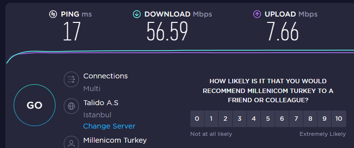

Selamlar, kısa süre önce TurkNet'ten Millenicom'a geçiş yaptım. Belirsizlik içinde internetim kopuyor. Evin iç tesisatını yaptırmam gerekiyormuş sanırsam. İç tesisat hakkında hiçbir bilgim mevcut değildir. Ek olarak bulunduğum bina 6-10 yaş arası. Yardımlarınızı bekliyorum, teşekkürler.
Not: Alt yapımın desteklediği 80 megabit VDSL.
============================================================================= xDSLFwVersion: FwVer:5.12.21.0_B_A60901 HwVer:T14.F7_0.0 Line State: Up. Modulation: ITU G.993.2(VDSL2) Annex Mode: ANNEX_B. ============================================================================= INP downstream: 46638. INP upstream: 14855. shineGINPdownstream: 0 shineGINPupstream: 0 reinGINPdownstream: 0 reinGINPupstream: 0 TPSTC type: 64/65B PTM TC. near-end interleaved channel bit rate: 0 kbps. near-end fast channel bit rate: 61040 kbps. far-end interleaved channel bit rate: 0 kbps. far-end fast channel bit rate: 8191 kbps. near-end FEC error fast: 295454. near-end FEC error interleaved: 0 near-end CRC error fast: 6319. near-end CRC error interleaved: 0 near-end HEC error fast: 0 near-end HEC error interleaved: 0 far-end FEC error fast: 6 far-end FEC error interleaved: 0 far-end CRC error fast: 11. far-end CRC error interleaved: 0 far-end HEC error fast: 0 far-end HEC error interleaved: 0 DSL uptime : 1:19, 37 secs. DSL activetime :0 min, 16 secs. Downstream: relative capacity occupation: 100% noise margin downstream: 8.0 dB. output power upstream: 9.2 dbm. attenuation downstream: 8.0 dB. Upstream: relative capacity occupation: 100% noise margin upstream: 26.0 dB. output power downstream: 14.7 dbm. attenuation upstream: 0.0 dB. Bit table: carrier load: number of bits per tone. tone 0- 31: 00 00 00 03 46 66 77 78 89 99 87 88 87 88 88 67. tone 32- 63: 75 66 66 77 78 88 99 99 99 9a 99 aa aa aa aa aa. tone 64- 95: aa aa aa aa aa aa aa aa aa aa aa aa bb bb bb bb. tone 96-127: bb bb ba bb bb bb bb cc cc bb bb bc cc bb cc cc. tone 128-159: cc cc cc cc bb bb bb bb ba ba aa ab bb ba ba bb. tone 160-191: bb cc cc cc cc cc bb bb bb ba bb aa ba 9a ba aa. tone 192-223: aa aa aa a9 99 aa aa aa aa 9a a9 99 9a aa aa aa. tone 224-255: aa aa 99 99 99 9a aa 99 a9 89 99 99 98 99 99 99.
    31,8 KB · Görüntüleme: 36
Eve gelen kablolarda panodan panoya aktarım oluyor genelde yeni binalarda 2-3 tana gereksiz pano koyabiliyorlar bazen mümkünse bir elektrikçi çağırıp onlara baktırın oksitlenme nemlenme olabilir.
Teşekkürler, elektrikçi ile öğleden sonra iletişime geçeceğim. Ek olarak değerler ile ilgili bir sorun var mı bilgim maalesef ki yoktur.
