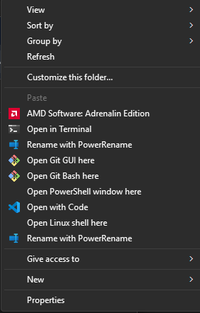

Runtime klasoru icerisinde terminal acin dedim. Runtime klasoru icerisinde python acin degil.
RVC-GUI/runtime klasorunde bos bir yere SHIFT + Sag click yaparsan burada powershell ac cikacak. Sonrasinda verdigim komutu yazacaksin. Python.exe'ye tiklamayacaksin.
Ilk defa mi terminal yada Python kullaniyorsun?

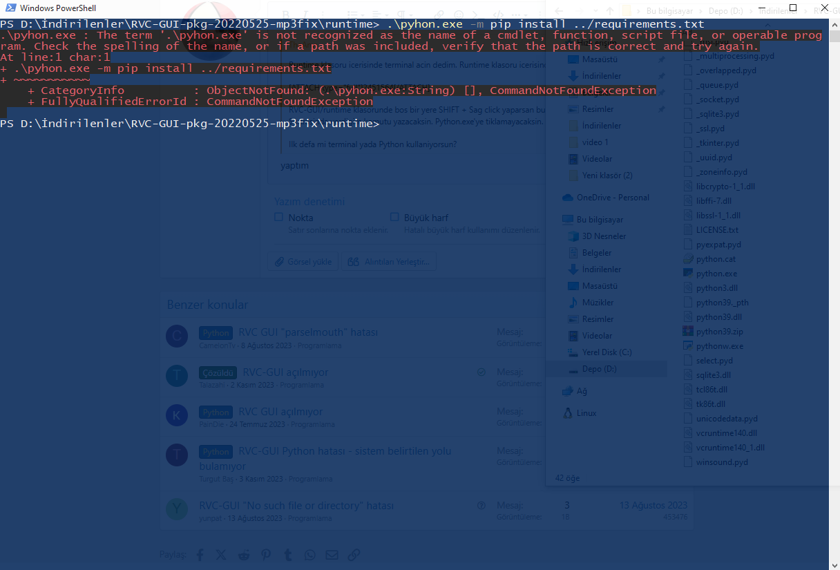

Ekleme komutta -r flagi'de olacak ..\requirements.txt'den once. Ama hala yanlis yerlerde yapiyor olman gibi bir problem var.
Eki Görüntüle 2451564

Yazim hatasi yapmisim. .\python.exe -m pip install -r ..\requirements.txt
Mesela;
Eki Görüntüle 2451575
Calisiyor boyle yukleyince;
Eki Görüntüle 2451577
Treşekürler
Mesela;

File "D:\İndirilenler\RVC-GUI-pkg-20220525-mp3fix\runtime\lib\site-packages\setuptools\_distutils\core.py", line 148, in setup
_setup_distribution = dist = klass(attrs)
File "D:\İndirilenler\RVC-GUI-pkg-20220525-mp3fix\runtime\lib\site-packages\setuptools\dist.py", line 322, in init
Distribution.__init_(self, dist_attrs)
File "D:\İndirilenler\RVC-GUI-pkg-20220525-mp3fix\runtime\lib\site-packages\setuptools\distutils\dist.py", line 309, in __init_
self.finalize_options()
File "D:\İndirilenler\RVC-GUI-pkg-20220525-mp3fix\runtime\lib\site-packages\setuptools\dist.py", line 787, in finalize_options
ep(self)
File "D:\İndirilenler\RVC-GUI-pkg-20220525-mp3fix\runtime\lib\site-packages\setuptools\dist.py", line 807, in _finalize_setup_keywords
ep.load()(self, ep.name, value)
File "D:\İndirilenler\RVC-GUI-pkg-20220525-mp3fix\runtime\lib\site-packages\importlib_metadata\init.py", line 210, in load
return functools.reduce(getattr, attrs, module)
File "D:\İndirilenler\RVC-GUI-pkg-20220525-mp3fix\runtime\lib\site-packages\setuptools\dist.py", line 82, in getattr
raise AttributeError(f"module {name!r} has no attribute {name!r}")
AttributeError: module 'setuptools.dist' has no attribute 'check_test_suite'
[end of output]
note: This error originates from a subprocess, and is likely not a problem with pip.
error: metadata-generation-failed
× Encountered error while generating package metadata.
╰─> See above for output.
note: This is an issue with the package mentioned above, not pip.
hint: See above for details
Bu hatayı çözmek için, eksik olan "pyworld" paketinin yüklenmesi gerekiyor. Aşağıdaki komutla bu paketi yükleyebilirsiniz:
pip install pyworld
Bu işlem hatayı düzeltecektir.
